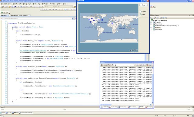

James,
I ran you demo as you can see from the screen shot.  There is no debug info in the code so there is nothing in the output window.  I am submitting this as a bug.
Ed
