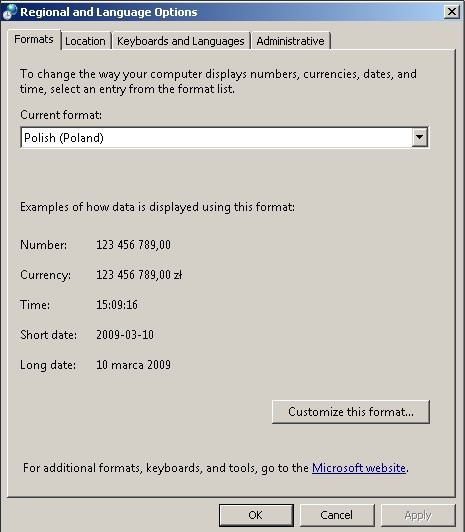

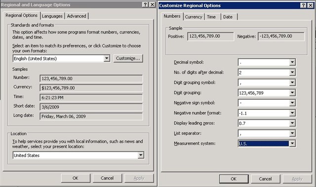

Pierre, can you change the decimal value's separator to period on your French machine?
Click "Customize"

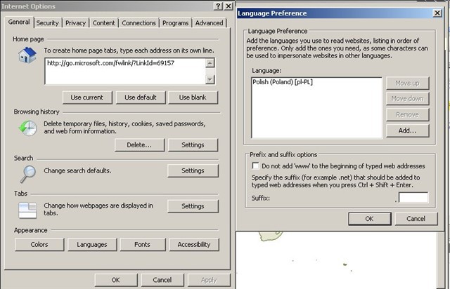

However, I still couldn't recreate the issue following your instructions. I changed all my settings to Polish (go to The “Regional Options” Panel, change to Polish / Poland and change it to Polish in “Advanced” panel ) and hook up the MapClick event, everything still goes fine. So Could you let me know in detail how to recreate that issue? Also could you tell me what encoding it is of your browser?

3, Create a new application which works fine. I'm using IE7 and I noticed that the language Preference has been set to pl-PL by default.
