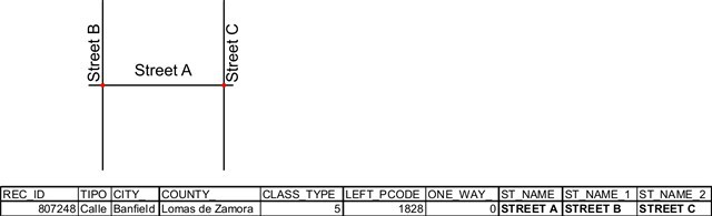

I would like to know if it possible to automatically add two columns in the database of my shape file containing the name of the intersecting streets.
In my shape I just have the ST_NAME column with the street name, and I would like to make a project that find the intersecting streets of all features and generate a new dbf with two new column called ST_NAME_1 and ST_NAME_2.
Since my English is not so well I’ve attached an image explaining what I would need.
Thank you very much.
Best Regards,
Leandro
Sorry, I didn't attached the file, here it is.

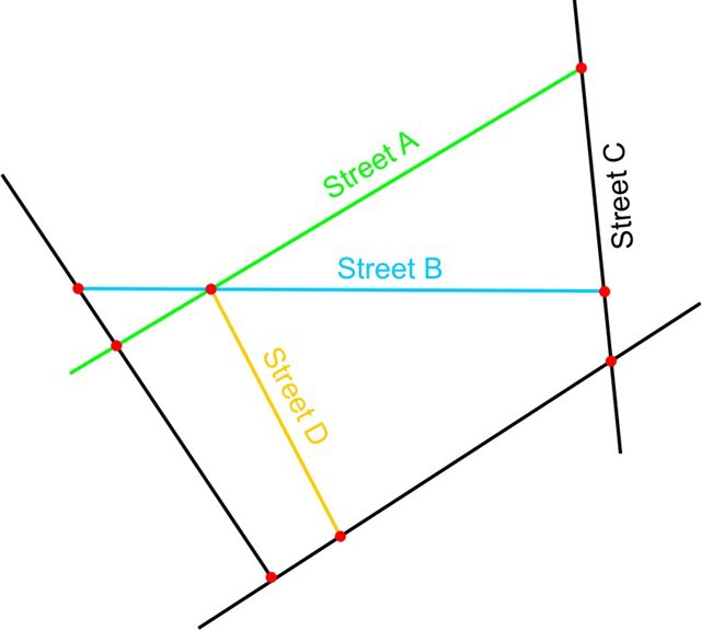

Hello Val,
To be honest, I didn’t think of it, you are talking about cases in which a corner has 3, 4 or 5 streets, like in the example below? In such cases it would be great instead of add two columns called ST_NAME_1 and ST_NAME_2 like I said before; add all necessary columns called INTERSECTING_1, INTERSECTING_2, INTERSECTING_3, ETC. But for my project I don’t care if I just listed 2 intersecting since Street A Between Street B and Street C, it’s going to be the same that Street A Between Street D and Street C, or even that Street A Between Street D and Street B which is the worst combination.

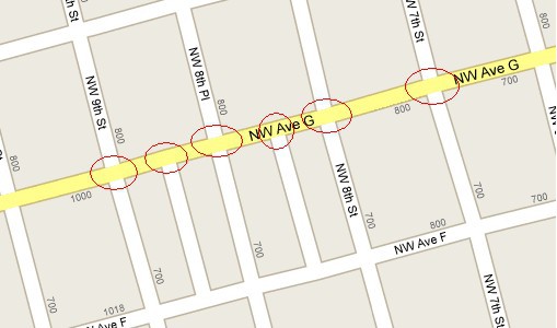

Actullay, the multiple intersectings are prevalent, for example, I search any streets on the google maps, it always has multiple intersectings, please see the case below:
Even, I think one street has more than 10 intersectings, I think maybe you can build your own custom data to store the intersecting information and the custom data can add field dynamically.

For the case you are pointing, the intersecting streets are always two, please see the image below and let me know if I’m wrong.

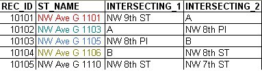

I understand your mean fully, maybe at first I misunderstood anything, in your case above, the NW Ave G street was seperate to many segments, that's right, we seperate the street according to the street number, so the table should be this:
You can see in the ST_NAME field, we need to record the street name with street number so that we can identify the special street segement.

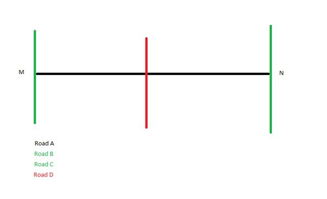

Here is the general way how to get it.
1, Get the intersecting Roads. For example, we want to get the intersecting roads for Road A, if both the green one and the red one are all intersecting roads, we can call
            layer.QueryTools.GetFeaturesIntersecting(RoadA, "ST_NAME");
If we just want to get the green roads, we need to call the following 2 methods
            layer.QueryTools.GetFeaturesIntersecting(PointM, new string[] { "ST_NAME" });
          layer.QueryTools.GetFeaturesIntersecting(PointN, new string[] { "ST_NAME" });
From the returned features, we can get the Name of the intersecting roads.
