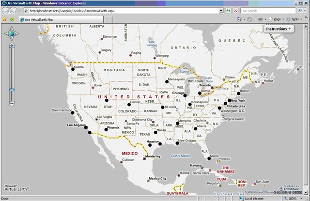

Sure you can integrate your shape file data with Virtual Earth / Google Map background. Here is some code with the latest edition which will be available pretty soon.
protected void Page_Load(object sender, EventArgs e)
            if (!Page.IsPostBack)
                Map1.BackgroundFillBrush = new GeoSolidBrush(GeoColor.FromHtml("#B3C6D4"));
                Map1.MapUnit = GeographyUnit.Meter;
                // Following is a proper extent for showing US in virtual earth, apparently, it doesn’t use Decimal Degrees.
                Map1.CurrentExtent = new RectangleShape(-13939426.6371, 6701997.4056, -7812401.86, 2626987.386962);
                Map1.MapControls.MousePosition.Enabled = true;
                // Create a shape file Layer including major cities in US
                ShapeFileFeatureLayer shapeFileFeatureLayer = new ShapeFileFeatureLayer(@“C:\Program Files\ThinkGeo\Map Suite Web Full Edition 3.0 (Beta)\Samples\CSharp Samples\SampleData\USA\cities_a.shp”);
                shapeFileFeatureLayer.ZoomLevelSet.ZoomLevel01.DefaultPointStyle = PointStyles.CreateSimpleCircleStyle(GeoColor.StandardColors.Black, 12f);
                shapeFileFeatureLayer.ZoomLevelSet.ZoomLevel01.ApplyUntilZoomLevel = ApplyUntilZoomLevel.Level20;
                shapeFileFeatureLayer.DrawingMarginPercentage = 50;
                // We need to set the projection for the shapefile layer to make it as same as Virtual Earth
                Proj4Projection proj4 = new Proj4Projection();
                proj4.InternalProjectionParametersString = Proj4Projection.GetEpsgParametersString(4326);
                // VE has the same projection with GoogleMap, so we call the following method to get the projection string.
                proj4.ExternalProjectionParametersString = Proj4Projection.GetGoogleMapParametersString();
                shapeFileFeatureLayer.FeatureSource.Projection = proj4;
                // Add the shapefile layer to layer overlay
                LayerOverlay layerOverLay = new LayerOverlay();
                layerOverLay.IsBaseOverlay = false;
                layerOverLay.Layers.Add(shapeFileFeatureLayer);
                // Create the virtual earth overlay
                VirtualEarthOverlay ve = new VirtualEarthOverlay(“VirtualEarth Map”);
                ve.VirtualEarthMapType = VirtualEarthMapType.Road;
                // Add the 2 overlays into map
                Map1.Overlays.Add(layerOverLay);
                Map1.Overlays.Add(ve);
Here is the result. The round black circle (I know that not looks good, just make it significant so you can tell it’s not from VE itself) is from the shape file I added with the above code.
