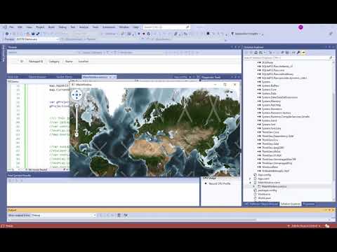

Thanks Dennis,
I created a sample for you to load the ECW, MrSid, GeoTiff, JPeg2000 And Projection Convert. Demo.zip (1.2 MB)
To re-project the raster layer we’d better use overLay.TileType = TileType.SingleTile;
Here is what it looks like.
