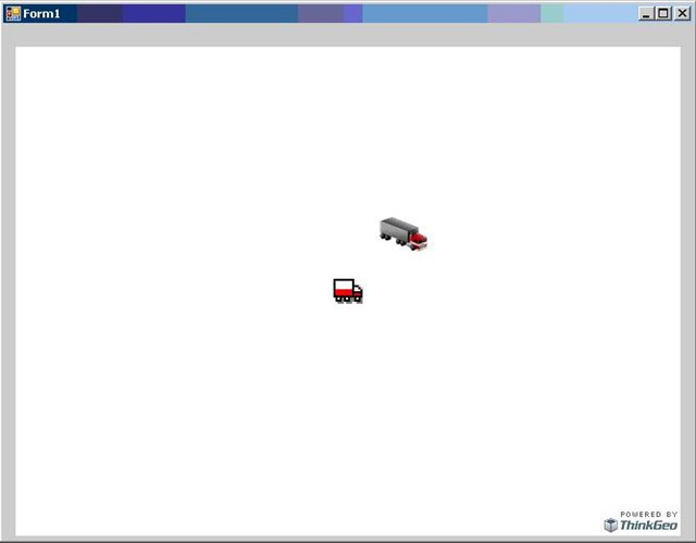

Result:

Thank you ben!
 This is what I was doing to add features:
 Dim feature As New Feature(x, y, entity)
 feature.ColumnValues.Add("ID", entity)
 But it works with your way, thank you very much
