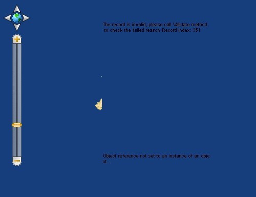

Sometimes on the map it displays 'the record is invalid, please call the Validate method to check the failed reason. Record Index: 97'
- Why doesn't it include the reason in the exception information?
- The Validate() method doesn't seem to exist. How do I get at it (in the code above)?

Sometimes on the map it displays the text 'Object reference not set to instance of an object'.
System.NullReferenceException was caught
Message="Object reference not set to an instance of an object."
Source="MapSuiteCore"
StackTrace:
at ThinkGeo.MapSuite.Core.ShapeFileFeatureSource.x0bb99de02aec07fa(x6193df574f38e922 xb55aa7011f50124f)
at ThinkGeo.MapSuite.Core.ShapeFileFeatureSource.OpenCore()
at ThinkGeo.MapSuite.Core.FeatureSource.Open()
at Emb.Msmo.WebSite.UserControls.Charts.ResultsMap.KpiGroupLayer_CustomColumnFetch(Object sender, CustomColumnFetchEventArgs e) in D:\Projects\msmo-trunk\msmo\Source\Emb.Msmo.WebSite\UserControls\Charts\ResultsMap.ascx.cs:line 64
InnerException:
just
HELP! It looks rubbish. Not something we can give to users. See:

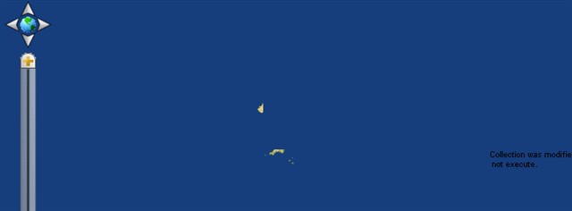

It turns out that Map1.StaticOverlay.Layers.COunt is zero.
The user sees the image attached.
If I press the zoom in button and wait a long time (~ 8 seconds) the map does draw correctly, but obviously that's not really acceptable.

 2, I see there is an exception in the screenshot about “collection was modified enumeration operation may not execute.”. Is there any logic in the event?
 3, I’m not sure why the layers count is zero, could you please provide us a sample we can easily recreate your issue?
