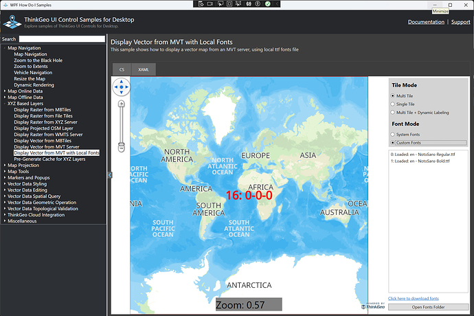

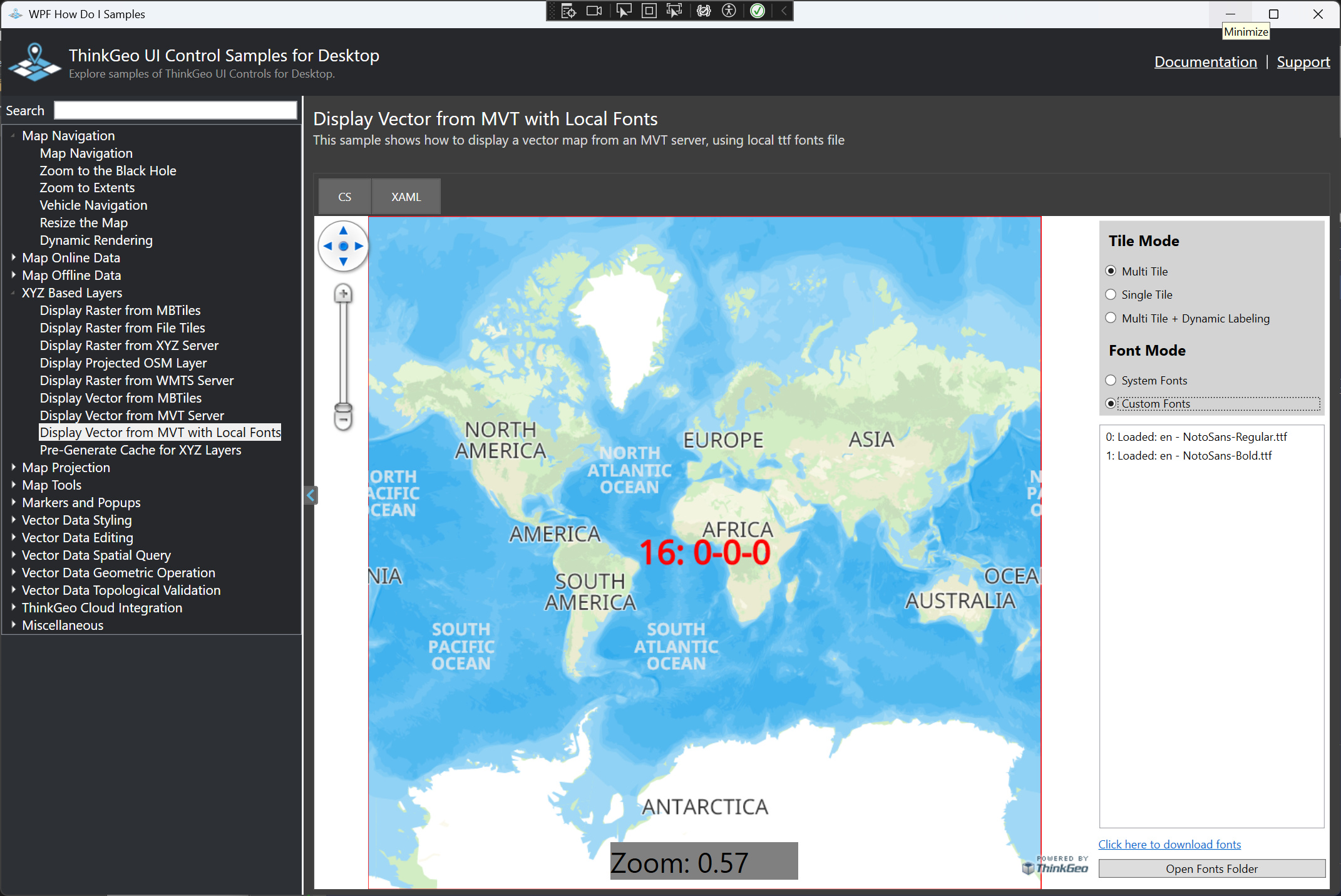

We’ve added local file support in the latest beta, v14.5.0-beta001. Please pull the latest version and give it a try.
A couple of notes:
  1. You can now use a local sprite file like this:
    "sprite": "./sprite"
  2. Glyph files are handled differently. The glyph .pbf files are available for web clients, but not for desktop (WPF).
    To make it work on desktop, you can either use the default system fonts or map your custom fonts to local .ttf files.
We’ve created a new HowDoI sample (currently in the dev branch — it will be merged into master soon) that demonstrates how to use custom font files. Have a try and let us know if you have any questions.
