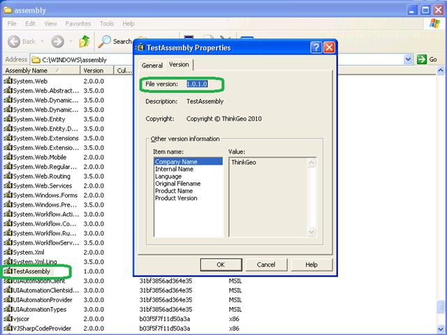

Here attached is a small sample showing how to make an msi installer to update a GAC assembly with same Assembly Version but different File Version.
There are 3 files attached, one Dll, one Msi and the source file for the Msi.
1, First, copy TestAssembly.dll to GAC. This dll has Assembly Version 1.0.0.0 and File Version 1.0.0.0
2, Install Project1.msi
3, check the GAC again, you will see the file version is becoming to 1.0.1.0.
4, if you want to remove the assembly in GAC, go to Control Panel->Add or Remove Programs->Uninstall the “MyGacTest” program.

You can see the key point is adding the following line to the proj file.
<SetMsiAssemblyNameFileVersion>True</SetMsiAssemblyNameFileVersion>
3, As far as I know, Microsoft’s own Setup Project cannot do this. One strange thing is that if you right click a setup project and click “Install” (like following), the project does update the assembly in GAC even only the File Version is different. But if you double click the generated msi file, that’s another story. That’s why I thought Mirosoft’s Setup Project can also implement that by mistake.
