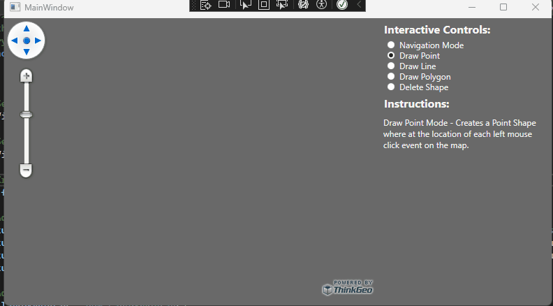

I also created a sample for your scenario, I moved the adding vertex 2000 meters to right, so you could see that every vertex I added was 2000 meters to right of where I clicked.
vertex_adding_sample.zip (13.6 KB)
vertex_adding
Leo
