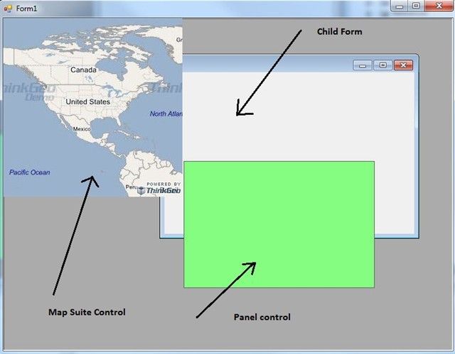

In my app, I'm designing my UI using MDI. My map, in the MDI Parent, will occupy the entire app screen (Fill). The problem is that the MDI child forms get bellow the map control, as shown in the image. Is there a way to get around this issue?
 Your issue is more a general programming issue than an issue specific to our map control. As you can see in the screen shot, this problem exist with any other control. Let us do some research on the MDI structure and we will let you know what the solution is.
