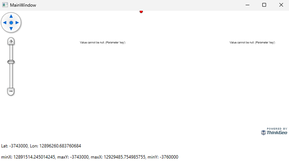

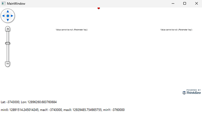

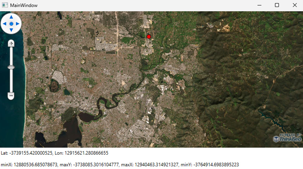

14.2.1 Result:
14.2.2 Result
Crash
System.ArgumentNullException: ‘Value cannot be null. (Parameter ‘key’)’
ThinkGeo.Core.Overlay.7EY=.MoveNext()
ThinkGeo.Core.MapViewBase.WEY=.MoveNext()
ThinkGeo.Core.MapViewBase.WkY=.MoveNext()
ThinkGeo.Core.MapViewBase.VkY=.MoveNext()
ThinkGeo.Core.MapViewBase.U0Y=.MoveNext()
ThinkGeo.Core.MapViewBase.k0Y=.MoveNext()
ThinkGeo.Core.MapViewBase.kkY=.MoveNext()
14.3.1 Result
Hi Daniel,
Thanks for the demo code! It’s an issue introduced after v14.2.1, and it has been fixed in the latest beta (14.4.0-beta044), this fix will be included in the upcoming release v14.3.2, which is about to be available by the end of this month.
Was this not included until 14.4.0? I was running 14.3.2 and it was not working. I updated to 14.4.0, which is out now, and voila!
It looks like it slipped past 14.3.2—glad it’s working now!
