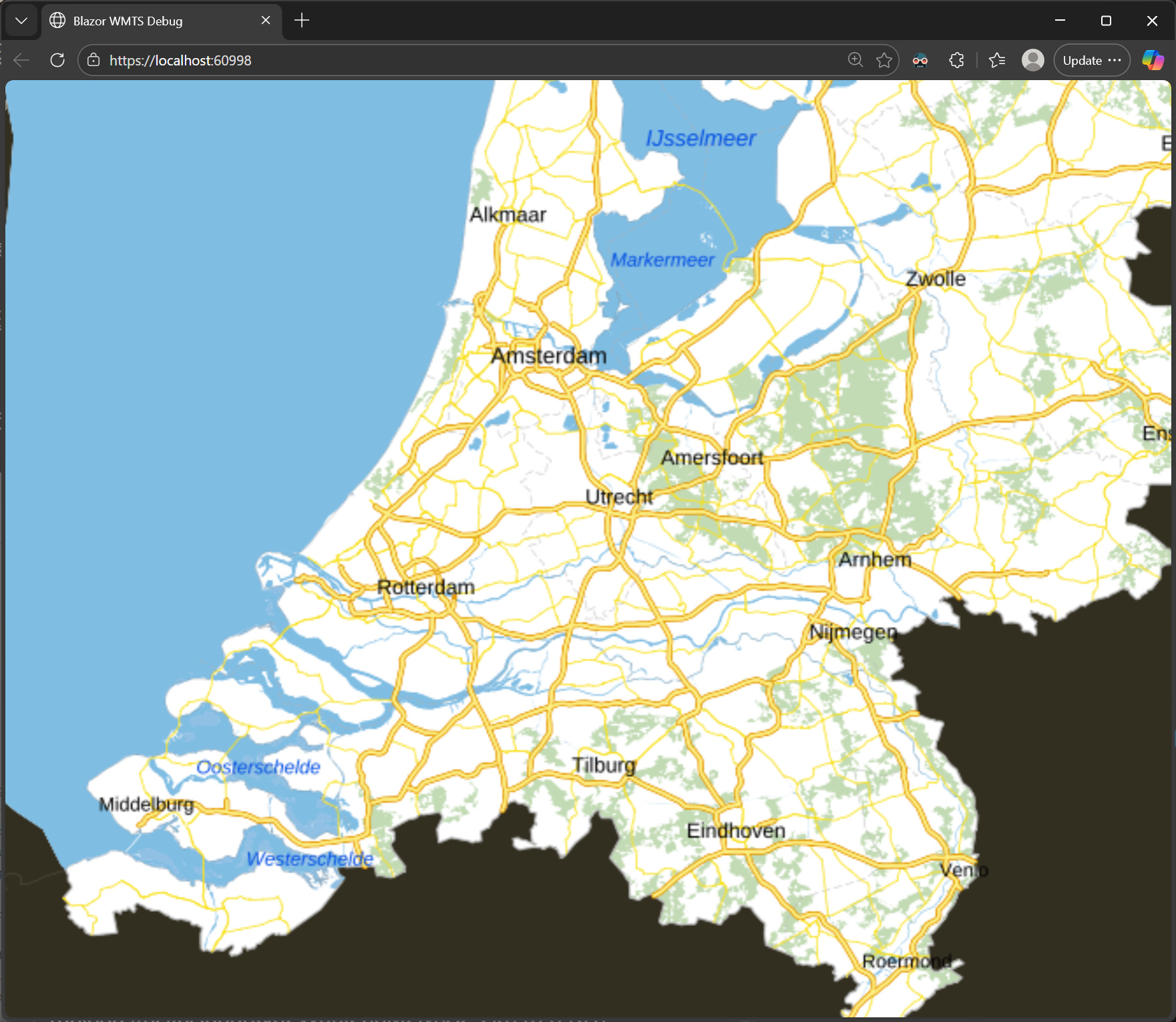

Hi Guido,
Here is a demo for you consuming https://service.pdok.nl/brt/achtergrondkaart/wmts/v2_0:
BlazorWmtsDebug.zip (5.3 KB)

Hi Guido,
Here is a WebAssembly sample using the latest beta package of Blazor, please have a look.
BlazorWmts_WASM.zip (4.6 KB)
Hi Ben,
In your demo app it seems to be working. But I’m unable to make it work in my own application.
