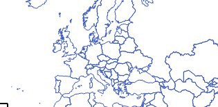

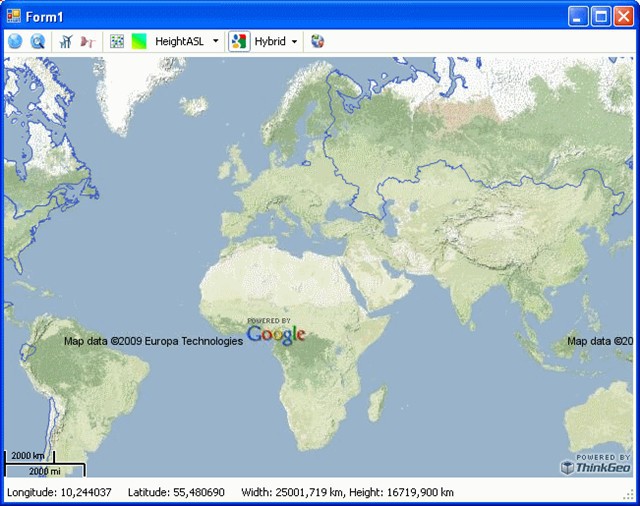

World layer not showed completly
When using map control in meters, the country layer dont show completly when zooming out, with white backgorund
have fun to find the correct region :)

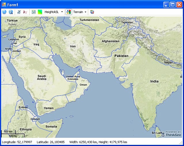

The country contours are visible when zoom in (blue).
I have made some screenshot where the google layer is enabled,

This is a known issue for Projection; One way to go around this is pre-project the data instead of projecting it on the fly.
Following code shows the way, hope it helps:

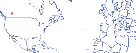

Have made some screenshoots, the problem is in the bitmap layer.
To recreate problem, zoom intoworld map, insert some bitmaps and then zoom up/down. ( I insert about 400 points around world, most europe)
Some time the map only displays some, all and none.
Only zoom up/down add removes icons, panning at same zoom, dosen't make any difference.

Pictures are at different zoom levels.
europe empty :(
Total blackout
Testet with version 3.0.411 same problem
 /Lars
