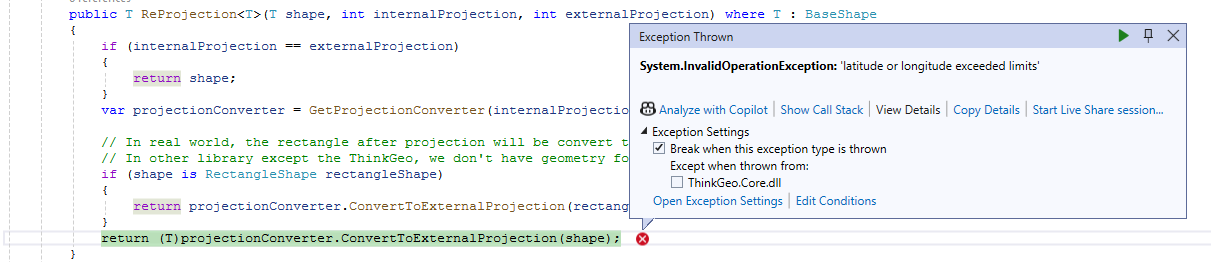

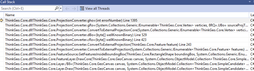

I am facing the following issue when the zoomlevel is set to Level 3 which is custom =>147647947.5
System.InvalidOperationException: latitude or longitude exceeded limits

Here is a trick for you to debug, you can replace your ProjectionConverter with your own custom class:
class MyProjectionConverter : ProjectionConverter
    protected override Collection<Vertex> ConvertToExternalProjectionCore(IEnumerable<Vertex> verticies)
        return base.ConvertToExternalProjectionCore(verticies);
Then whenever it throws an exception, you can get the vertices which causes the exception. Send over those vertices to us and we can dig in.

Hi Ben,
Sorry for the confusion, I am using following
var projectionConverter = new ProjectionConverter(internalProjection, externalProjection);
projectionConverter.Open();
projectionConverter.ConvertToExternalProjection(shape) <== this is the line which is causing error
inputs :
shape => -24579533.175198,13840383.2507416,0
internalProjection =>3857
externalProjection => 27700
Could you please help here?
