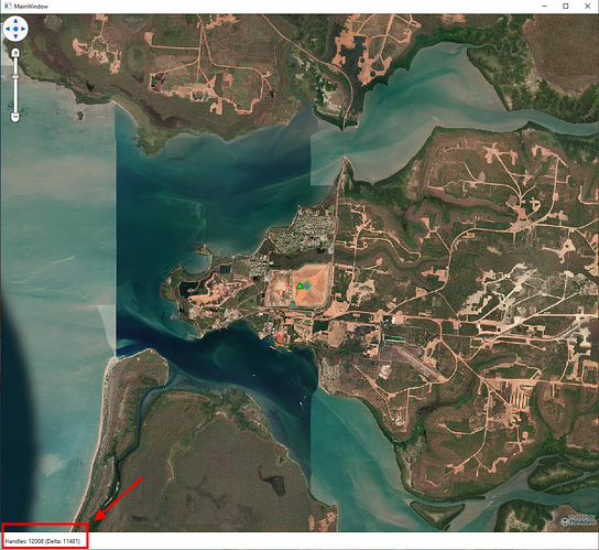

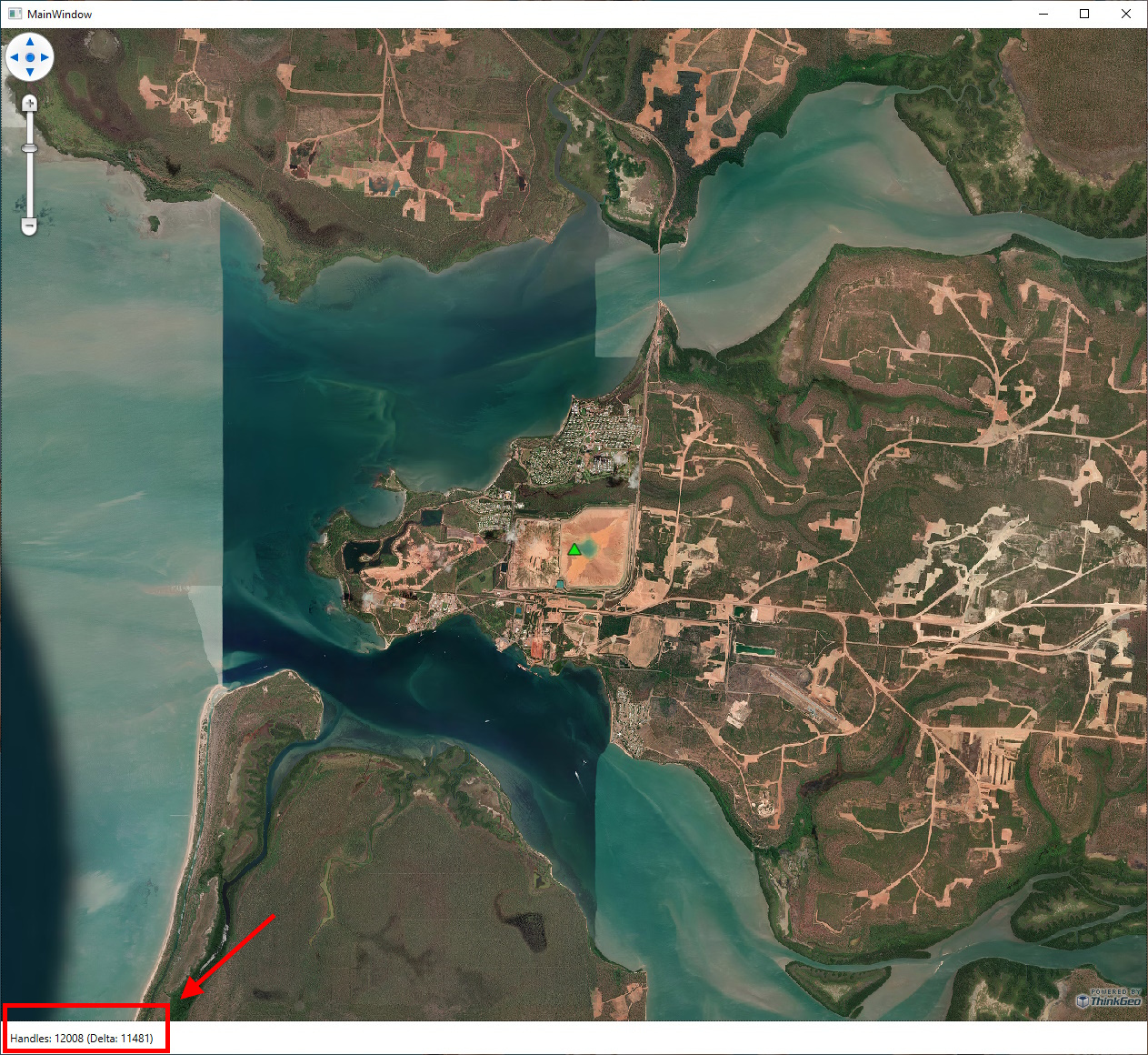

Handle Count is increasing
We have an application using ThinkGeo for WPF version 14.2.6
The application is leaking Handles (Event) causing the application to crash after some days run.
We have identified that the Handles leak is coming from ThinkGeo map.
We have reproduced the behaviour in a demo WPF application (a main window, ThinkGeo Desktop map loading a ECW raster map and a timer moving an Feature on the map).
The Feature is show using a simple geometric form created via using PointStyle.CreateSimpleTriangleStyle
The Feature position is updated by removing the old feature and adding a new feature with the updated position:
GeoCollection coll = m_LayerNodes.InternalFeatures;
Feature feature = new Feature(longitude, latitude, KEY_Node);
feature.ColumnValues[NODE_TITLE_COLNAME] = “Test”;
feature.ColumnValues[NODE_STATE_COLNAME] = nodeState;
if (coll.Contains(feature.Id)) coll.Remove(feature.Id);
coll.Add(feature.Id, feature);
Via PerfMonitor we have monitored the Handler Count which is increasing
The same behaviour can be reproduced by panning the map.

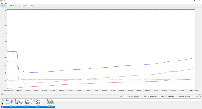

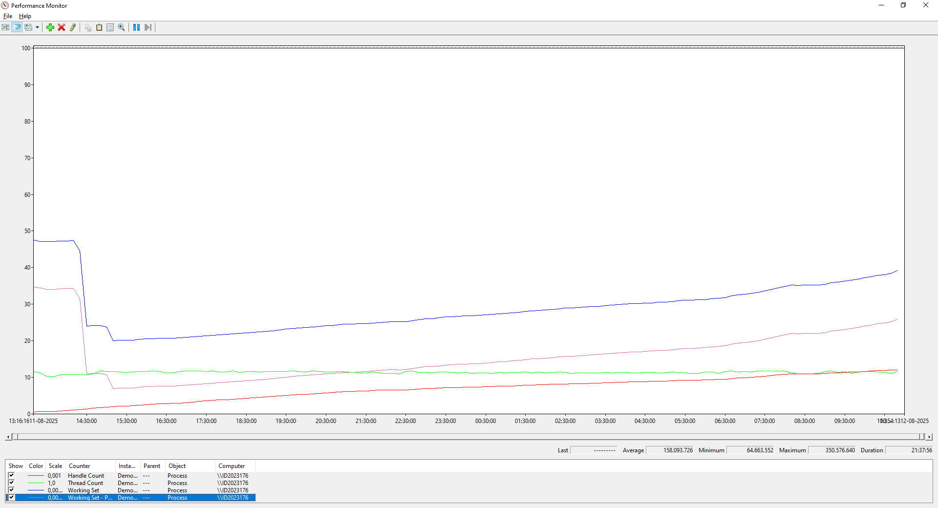

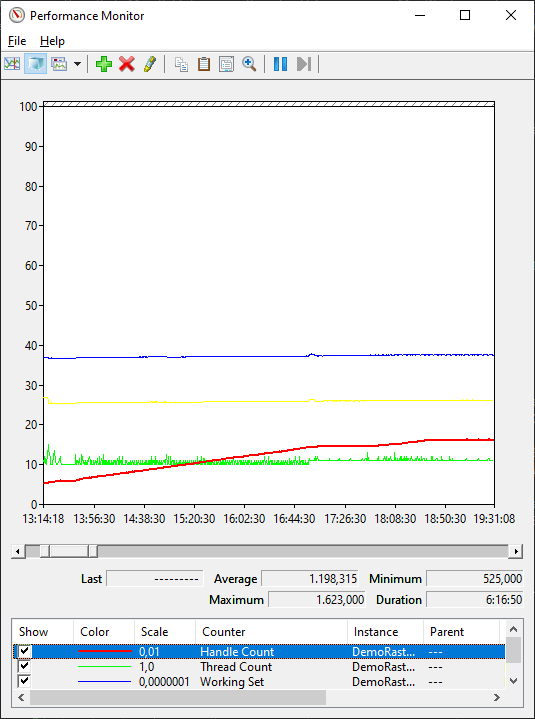

I am already logging the handle count; both in the demo app (start and current handle count) and via PerfMonitor.
WIN10_NET9_THINKGEO_14_2_6.zip (941.2 KB) WIN10_NET9_THINKGEO_14_3_2.zip (664.0 KB) DemoRasterMap_2025_08_12.zip (13.8 KB)
I have added the source code of the Demo App. The Demo App is extracted from our app, therefore there are some Projection code which is required by the official app, but the code could be different considering only the demo. I performed one build using the 14.2.6 version (used in the first test) and thereafter I upgraded the demo app to 14.3.2. I used the second build in my second test.
I have also added the complete PerfMonitor log for both tests.
The PerfMonitor log contains the Handle count, the Thread Count, the working set and the working set - private (which is very close to the data you requested).

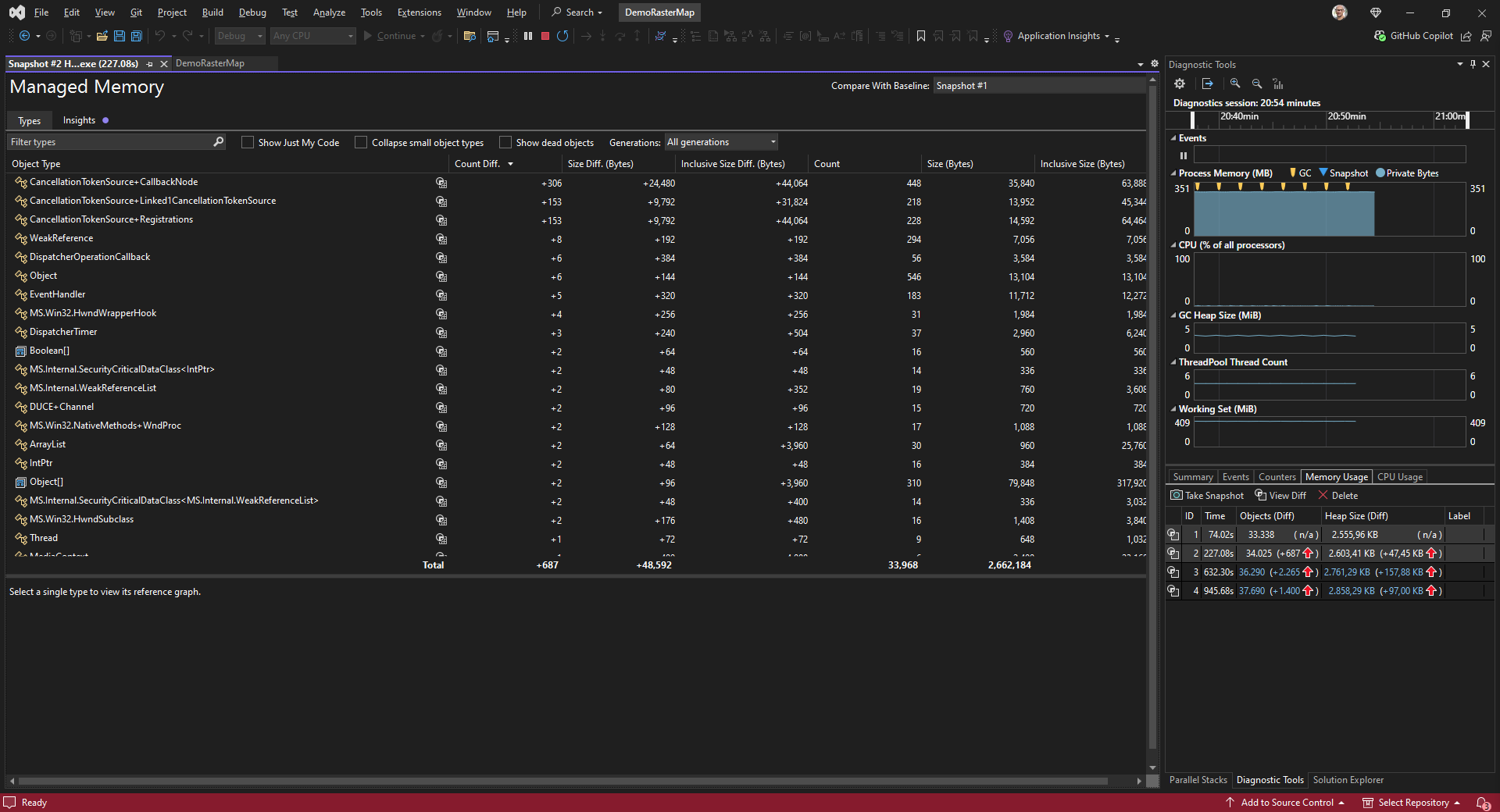

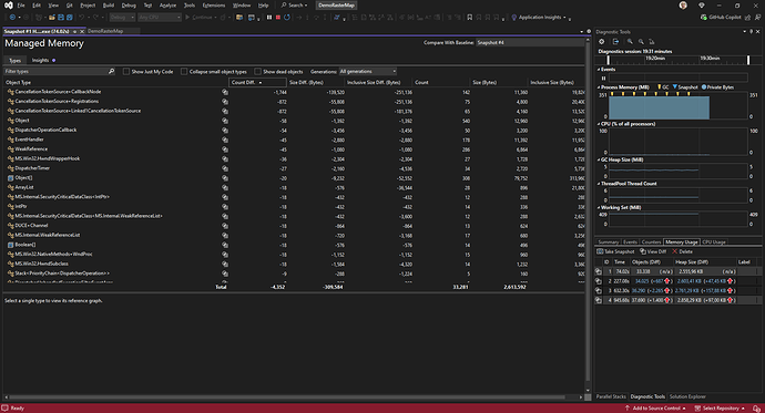

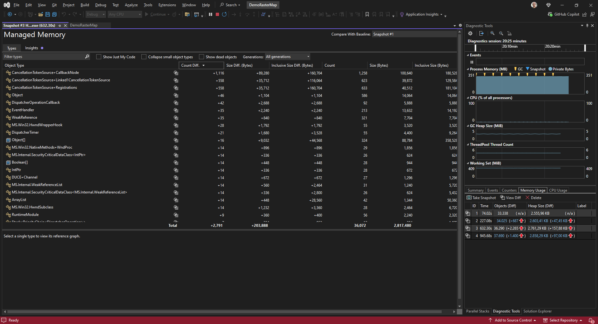

One other observation when running DEBUG version with the Diagnostic tools. The count of the CancellationTokenSource related object is increasing during the time:
Diff 1:
Diff 2:
Diff 3:
This could also be a reason for the increasing Handler Count.

Hi Domenico,
Thanks for sending the demo project — that was a big help.
I’m wondering which version you were using when you noticed the CancellationTokenSource count increasing. We fixed an issue in v14.3.0 (“ThinkGeo.UI.Desktop: improve performance by avoiding creating a new CancellationTokenSource when panning the map”), so I’d like to confirm whether you saw this behavior in v14.3.2 or v14.2.x.
Based on your data — v14.2.6 → ~11,000 handles in 22 hours vs. v14.3.2 → ~1,700 handles in 17 hours — it looks like v14.3.2 already shows a significant improvement, likely due to the CancellationTokenSource change, but there are still some handles not being released.
I’ve been running your demo project for almost an hour, and I can already see handle counts increasing. Our plan is to address this in the latest version first, then see if the fix can be backported to your version. That said, backporting may be difficult, and upgrading to the latest version might ultimately be required.

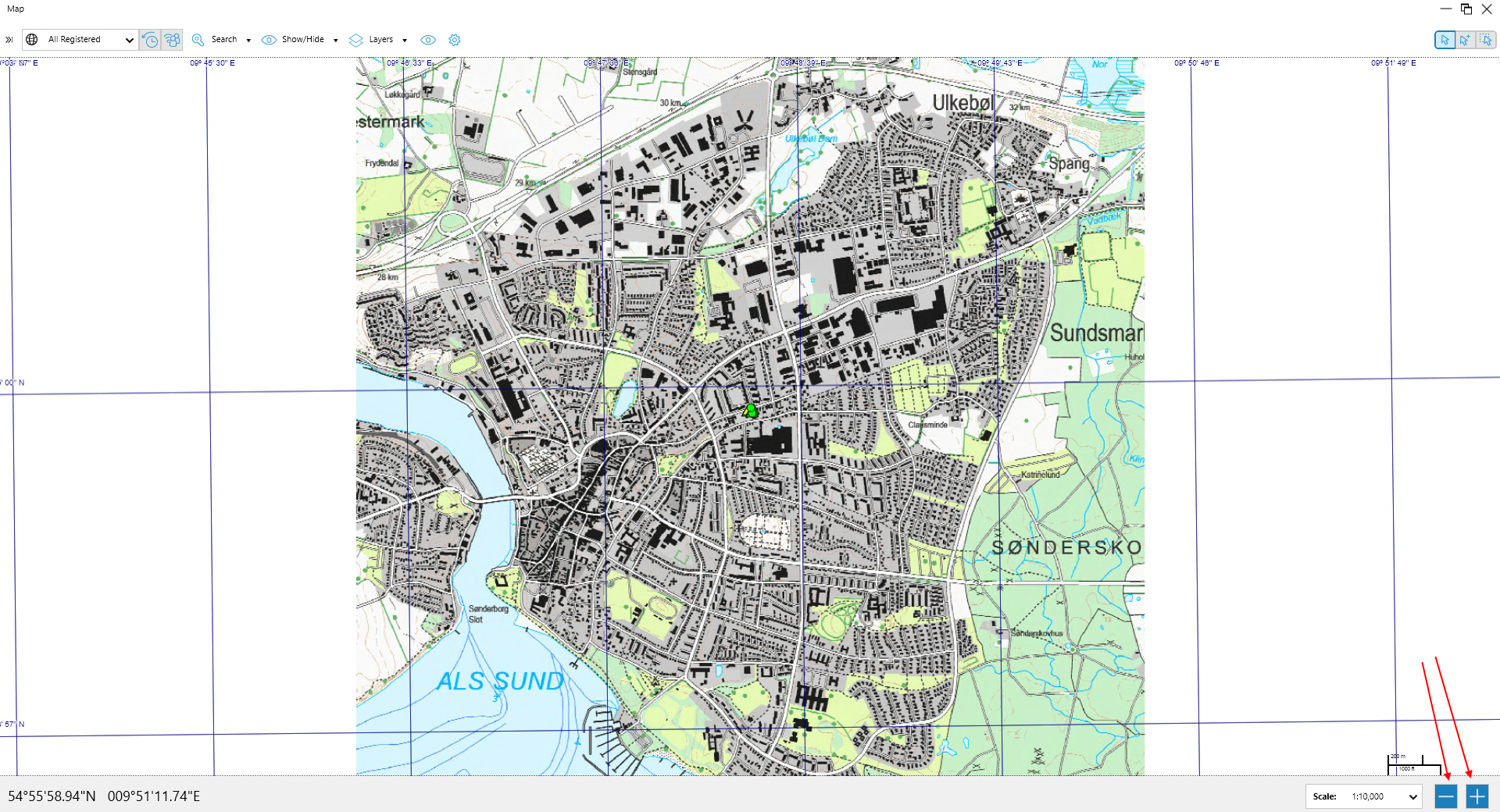

After upgraded our application to ThinkGeo 14.3.2 I am observing the cancellation exception as mentioned before. In some cases, the UI is not updated correctly when the cancellation operation is thrown.
For example, in our application the user can press the zoom buttons indicated by the red arrow.
In some cases when the exception is thrown then the UI panting operation seems to be stopped.
In the following log the line containing “Zoom the map to the selected Scale” is written just before the ZoomToAsync is called. From the timestamp in the log there is a time difference between the 2 calls of about 1 second (the user press 2 times on the button).
I 2025-08-15 13:52:33.276Z Damm.MapCtrl.WPF.View: Zoom the map to the selected Scale [Requested Scale: 7500][Corrected Scale: 7500][Current Extent: 9.794884334932853,54.920608499413156,9.817885628262747,54.90964359715807][Current Center: 9.8063849815978,54.915126048285615,0][Reason: ViewModel.RequestChangeCurrentScale]
I 2025-08-15 13:52:34.195Z Damm.MapCtrl.WPF.View: Zoom the map to the selected Scale [Requested Scale: 10000][Corrected Scale: 10000][Current Extent: 9.789134011600398,54.92334972497692,9.823635951595202,54.906902371594306][Current Center: 9.8063849815978,54.915126048285615,0][Reason: ViewModel.RequestChangeCurrentScale]
Exception thrown: 'System.Threading.Tasks.TaskCanceledException' in System.Private.CoreLib.dll
W 2025-08-15 13:52:34.462Z Damm.MapCtrl.WPF.View: Error setting the Scale [Scale: 10000][Reason: ViewModel.RequestChangeCurrentScale]
EXCEPTION: A task was canceled.
   at ThinkGeo.UI.Wpf.MapViewBase.REQ=(PointShape fromCenter, PointShape toCenter, Double fromResolution, Double toResolution, Double fromAngle, Double toAngle, UInt32 animationLength, EasingFunctionBase easing, Boolean fromMouseInteraction, CancellationToken cancellationToken)
   at ThinkGeo.UI.Wpf.MapViewBase.cEQ=(PointShape targetCenter, Double targetScale, Double rotationAngle, MapAnimationSettings animationSettings, CancellationToken cancellationToken, Boolean fromMouseInteraction)
   at ThinkGeo.UI.Wpf.MapViewBase.ZoomToAsync(Double targetScale, CancellationToken cancellationToken)
   at Damm.MapCtrl.WPF.MapView.SetScaleAsync(Double _scale, Boolean _isInitialScale, Boolean _doCorrectScale, String _reason, PointShape _centerAt, CancellationToken _cancellation) in D:\Repos\Releases\Ver08_12\Damm\DammMapCtrl.WPF\MapView.xaml.cs:line 4843
END EXCEPTION --------------------------------------------------------------------

Do you have any suggestion about how we can avoid the bad refreshing in the UI ?

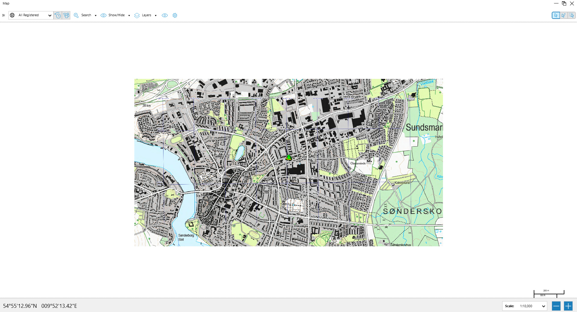

I made an example about the task cancellation problem I am facing.
As mentioned the map rendeing is an un-terminated state when this happen.
In the demo I reconfigure the scale when the windows change the size.
Sometimes the exception is thrown when the scale is reconfigued due to the windows is maximized.

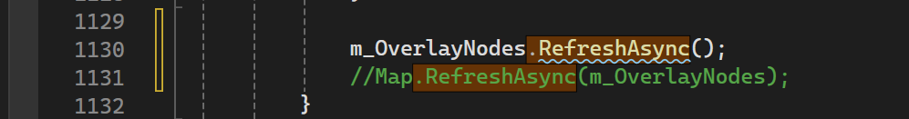

The last line in your UpdateNodePosition(), can you use m_OverlayNodes.RefreshAsync(); instead?
Reason: mapView.RefreshAsync() cancels any in-flight rendering . If UpdateNodePosition() fires while the background is still drawing, that global cancel makes the background appear half-rendered—exactly what you’re seeing.
m_OverlayNodes.RefreshAsync() only repaints that overlay and doesn’t cancel other rendering, so it’s lighter and avoids interrupting the base map.
Two extra tips:
  • The RefreshAsync() is not awaited (because it’s kicked off by a timer) so multiple refresh might happen at the same time.
  • Please play with FeatureLayerWpfDrawingOverlay (mentioned earlier in this thread) when having a chance, which works better for this scenario

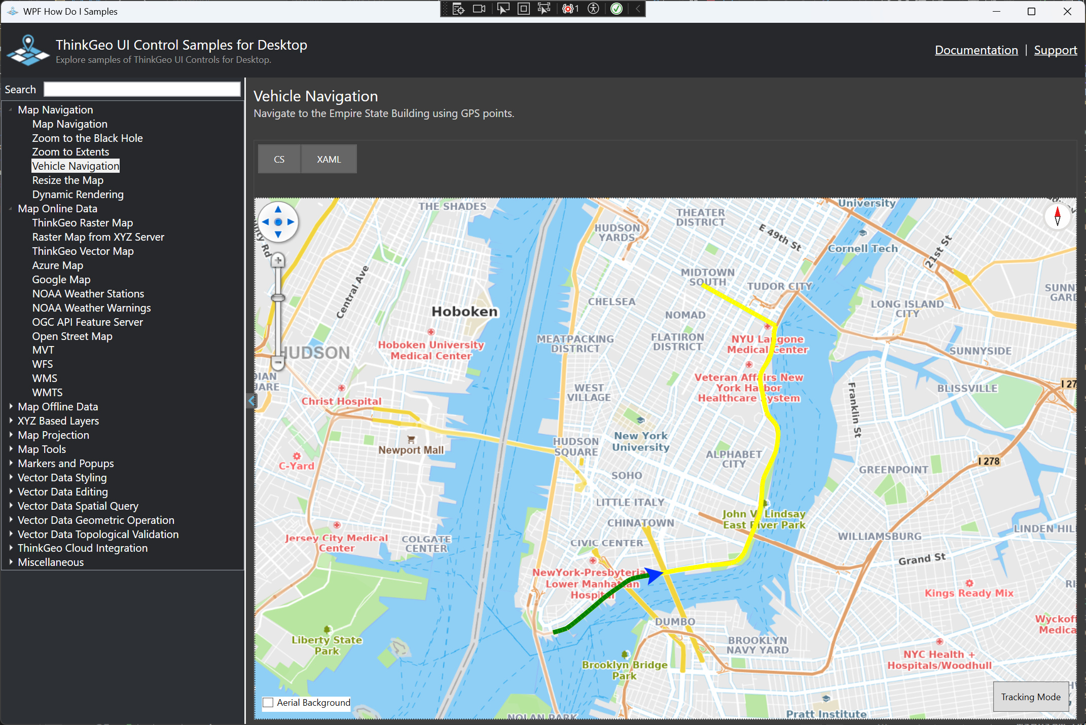

For a concrete reference, the HowDoI → Map Navigation → VehicleNavigation sample shows these pieces in action.

Hi Ben
I have updated our application with ThinkGeo 14.3.2 and I have serialized the calls to zoom, center, or refresh (only 1 call per time) in order to avoid the cancellation exception but I am facing 2 new problems with 14.3.2.
When the MAP is shown then our application process is taking long time to terminate on close (about 10 seconds). This has been observed both when running in DEBUG from Visual Studio (Diagnostic Tools) and when running in release build (Windows Task Manager).
The same behaviour can be observed also in the Demo app I uploaded in a previous post.
In both applications I have disabled the animation:
private void Map_Loaded(object sender, RoutedEventArgs e)
    Map.DefaultAnimationSettings = new MapAnimationSettings {
        Duration = 0,   // no animation
In our main application the MAP is shown in its own Window furthermore the application creates also other child windows in order to presents other information to the user.
If a child window is in front of the MAP view and the mouse moves over the MAP then the MAP is moving in front, and it is stealing the focus.
Do you have any suggestion how to solve the problems ?

We’ve identified the main cause of the handle count increase. When refreshing a LayerOverlay , the layer is drawn to an image on a background thread using Task.Run() , and then posted back to the map on the UI thread. We discovered that simply awaiting Task.Run will cause the handle count to grow. For example, you can reproduce this behavior by placing the following line in a Timer.Tick event:
await Task.Run(() => { });
This isn’t a true leak, but rather a case where the GC cannot keep up with releasing the underlying WaitHandle objects, so it appears like a leak.
We are still reviewing other leaks, but so far the only confirmed real handle leak we found was from CancellationTokenSource . That issue was fixed in v14.3.2 .
For your specific scenario, I recommend switching to FeatureLayerWpfDrawingOverlay , which is designed for dynamic layers refreshed in a timer:
  1. It doesn’t use Task.Run() — all drawing happens on the UI thread with hardware acceleration .
  2. It’s more suitable for incremental updates: instead of creating a large image each refresh, you can update just the relevant point, resulting in better memory usage.
