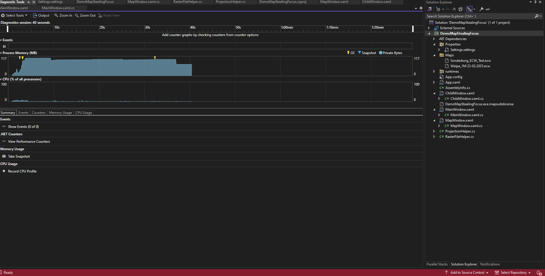

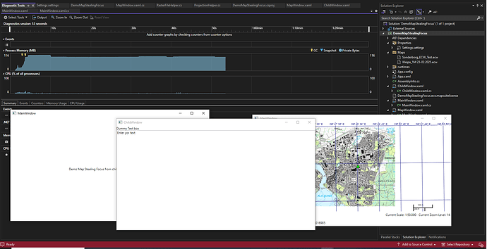

When the application is running:
3 ~4 seconds after the application is closed

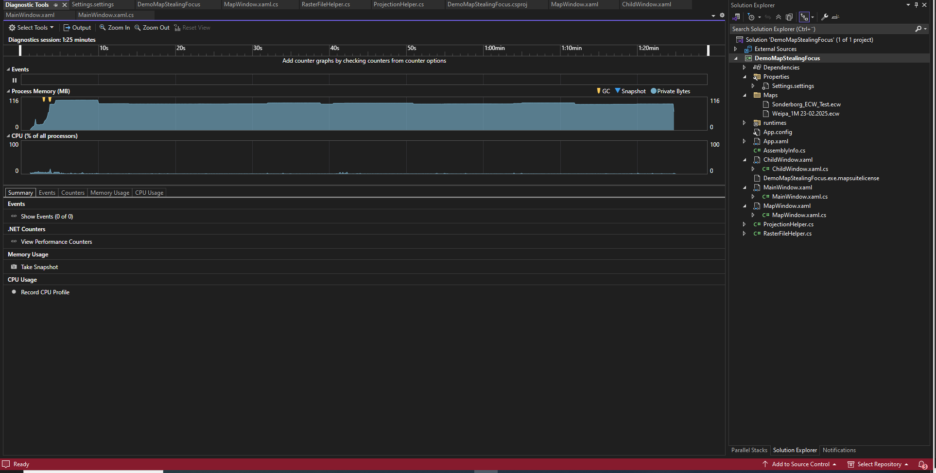

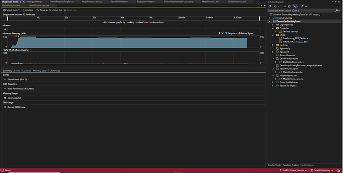

Finally the memory is slowly released and the process is terminated:
