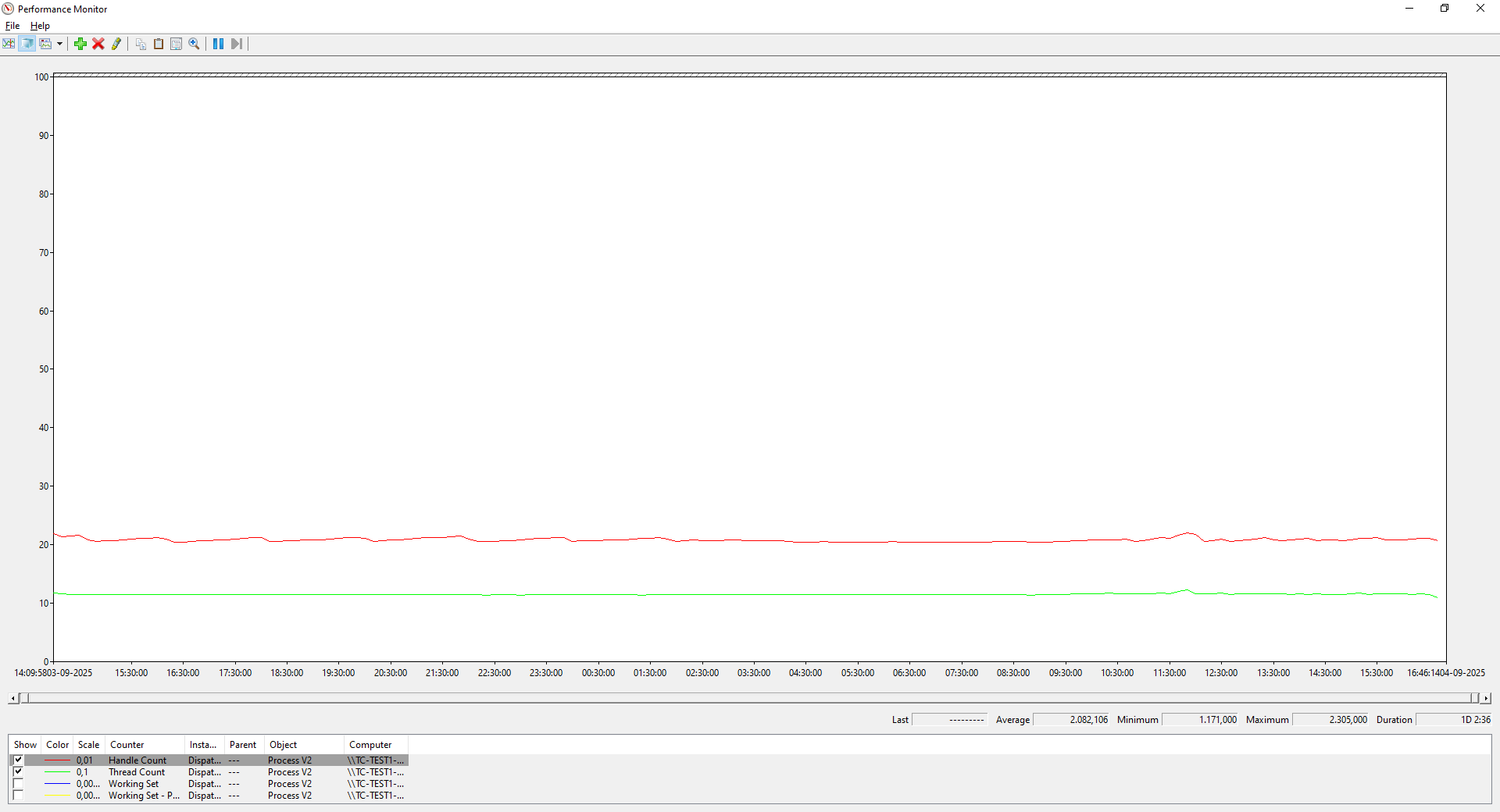

We have just terminated the migration from version 14.6.2 to 14.3.2 and we have performed some quick test in order to check if we cover the previous functionality. We will start long run and handle count test now, but it is my impression that the handle count is still increasing.
I will start 3 long run tests in parallel:
  • Our application with the map view open
  • Our application without the map view open
  • The demo application (the source code is in this thread)
I will collect the handle count on all the 3 cases, and I will report the result in this thread

Hi Ben
In a previous post you mentioned that you were able to see a handle count increasing which you point back to Task.Run (which is used when refreshing LayerOverlay).
Where you wrote:
“This isn’t a true leak, but rather a case where the GC cannot keep up with releasing the underlying WaitHandle objects, so it appears like a leak.”
What is ThinkGeo plan? Are you going to perform any action on this topic?
In the meantime, we are still monitoring the handle count in our updated application using ThinkGeo 14.3.2 and your suggested changes.
We would like also to include our customer which experienced the handle count issue, but we are waiting a solution for the crash (0xc0000374 and 0xc0000005) observed when using ECW with ThinkGeo version 14.3.2 (discussion: Map is delaying the process to close - ThinkGeo UI for Desktop / WPF - ThinkGeo Discussion Forums)
Best regards
Domenico

Hi Ben
I did not try the Task.Run sampe you sent. I trust in what you say.
I am measuring the handle count always with PerfMonitor from Windows.
Before upgrading to 14.3.2 the handle count in our application was increasing by letting the application running without user actions (only presenting the received positions updates).
After we upgrade to 14.3.2 and performed the suggested changes the same test does not present the increasing handle count.
From my point of view at the moment it seems that the handle count issue is solved by those changes and therefore this case is closed. We will try to load tests with user actions and if we get a different result then I will re-open this case.
