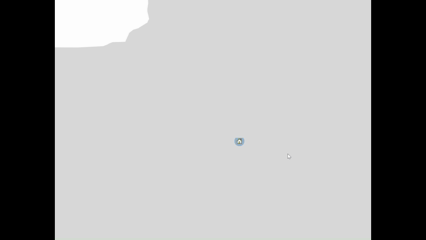

Highlights are sometimes cut off against transparent background
the surrounding accent is a transparent circle with a blue outline, added as a separate PointStyle. This path does not set PointStyle.Mask.

The circular outline surrounding newly added image point features is intermittently partially clipped in GPU rendering. The image and circle are separate entries in
ZoomLevel.CustomStyles, translated together using FeatureLayerTranslator.Translate.

Not depth fighting - it’s the shape of the loss: the ring stops on a straight line that is exactly a tile boundary, the missing side shows the map behind it rather than another layer, and whether it happens at all depends only on how far the highlight sits from that boundary. Two separate things, both fixed.
15.0.0-beta169
  • The ring was cut wherever a tile edge passed within its radius. Tiled geometry is clipped to its tile, and a tile carries features only a little past its own edge - about 8 px of 512 - so a ring wider than that lost the part that reached into the neighbour. A circle now belongs to the one tile that holds its centre, and that tile draws it whole. This is why it looked intermittent: it depended on where the highlight landed relative to a tile edge.
  • Your accent circle was also painted as a solid translucent disc rather than a ring. The GPU drew a circle as two discs, the outline colour with the fill colour over it - which only looks like a ring when the fill is opaque. GeoColors.Transparent left the outline disc showing. Fill and outline are now drawn in one pass, so a transparent fill gives you the outline you asked for, antialiased like the classic renderer.
Your code needs no change.
One thing to know
PointStyle.CreateSimpleCircleStyle puts the outline outside the symbol size, so the circle spans SymbolSize + 2 * outlineWidth. Your diameter already leaves a gap around the icon, so nothing to adjust - just worth knowing if you tighten it later.
