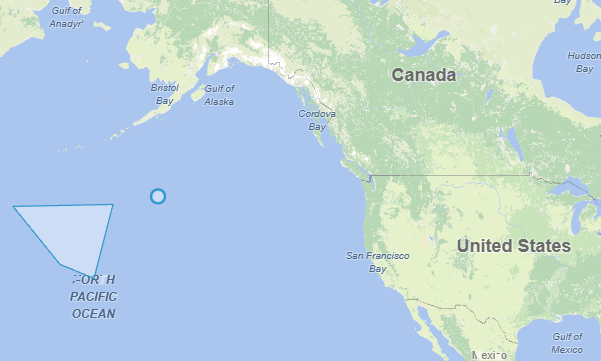

What are the units of measure used for "__tg_edit_circle_radius"?
I see that the current 15 beta now has FeatureDrawnEditOverlayEventArgs.ColumnValues["__tg_edit_circle_radius"] when drawing a circle what are those units of measure? I drew a small circle and the radius was 138365.8010475412 that does not appear to be meters.
It uses the unit of your current map (meters in your case), and you’re also correct that it’s not fully accurate.
When projecting the 3D Earth onto a 2D plane, some distortion is unavoidable. With Spherical Mercator (the projection your map is using), that distortion affects distance and area accuracy. As a result, a circle drawn on the map is not a true circle on the Earth’s surface, and the radius you see is based on the projected map—not the real-world distance.
If you need a more accurate measurement, you can use geodesic calculations. For example:
ellipseShape.GetArea(3857, AreaUnit.SquareMeters, DistanceCalculationMode.Haversine);
This calculates the area using a spherical model of the Earth and will give you a more accurate result.
